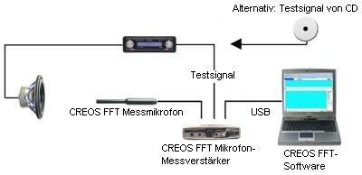

poti sa imi explici mai exact cum functioneaza? Eu am vazut si la DNA microfon si ceva placa de sunet... dar nu stiu exact cum se leaga....
 Subiectul mesajului: Re: Sistem de masurare raspuns difuzor/incinta acustica
MesajScris: Dum Apr 10, 2011 6:39 pm
Citat:
The system consists of a professional measuring microphone, a two channel measuring preamplifier and a sophisticated software, running on Windows 98SE/Me/2000 and XP.
The standard version of the software offers real time FFT analysis to measure frequency response using pink noise or sweep signals, and Dirac- or MLS pulses to analyse the pulse response. Comparison to a reference curve and adding several curves for averaging is as well possible as measuring the slope of parts of the measured curves.
For SPL competitions a special SPL mode is included, displaying the maximum SPL of one or two competitors during an adjustable time window.
Two channel or mono summed measurements are possible.
Optional modules are available: The EMMA module offers the measurement of frequency response and automatic calculation and displaying of the resulting points according to EMMA specifications.
Another module enables 3D waterfall display, a third module offers measurement of Thiele-Small parameters and impedance of speakers.
The optional SPL measuring microphone enables measurements up to 165 dBSPL.
Blockdiagram-neu_2005_klein_01.jpg [ 25.37 KiB | Vizualizat de 21851 ori ]
