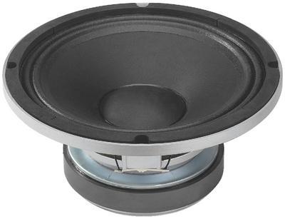

Buna ziua ,
Ce parere aveti de acest difuzor ?
Puteti ,va rog, sa mi recomandati o incinta ?
Am vazut discutii ca s ar recomanda taiere la 800hz sau 3000hz pentru doua cai . Cum ma sfatuiti?
Multumesc !

Cred ca in descrierea produsului ai toate datele necesare, poti face o simulare cu WINSD sau Bassbox.
IMG Stageline SPA-25PA Midrange Speaker, 250W Max. 8ohm 10"
PA midrange speaker, 250W Max, 8ohm;
PA bass speakers and bass-midrange speakers with aluminium diecast basket and stable paper cone with good inside dampening, high medium sound pressure, especially suitable for semiprofessional allround PA applications.
With very extensive midrange reproduction and interesting bass power for building smaller monitors or high-power 3-way speaker systems. HiFi-Selbstbau, Online magazine 2008
"The SPA-25PA from IMG Stage Line is a really reliable PA speaker of good workmanship ... ideally suitable for stage monitors of compact size. The downright sensational price is awesome."

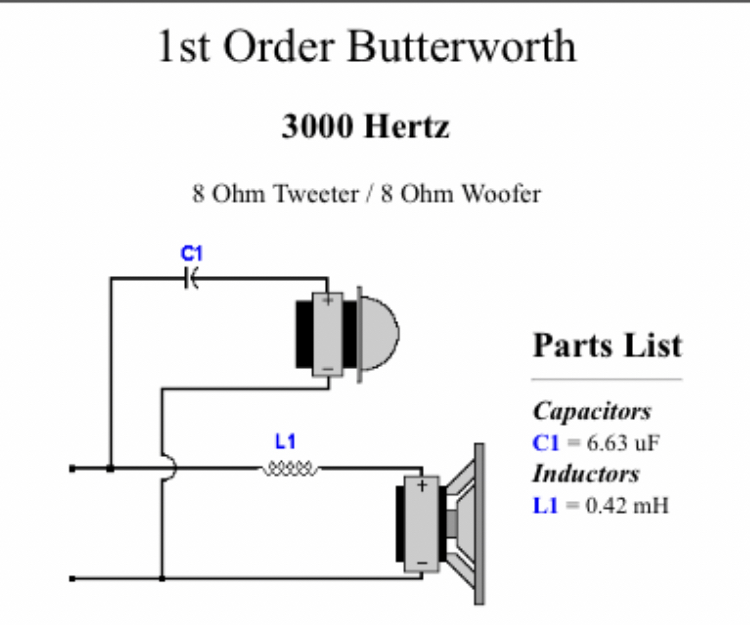

Am incercat acest filtru !

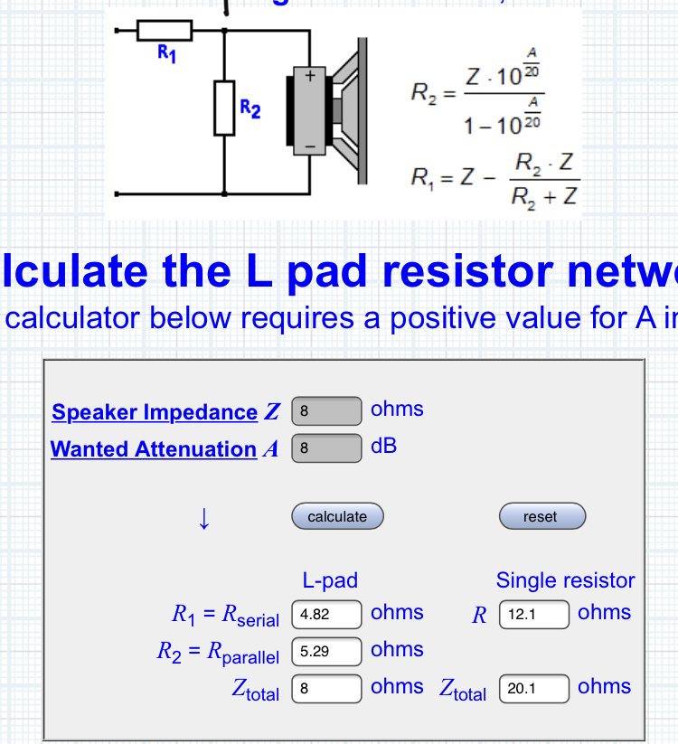

Nu ai L-pad ?
De aceea nu ai joase deloc. Inaltele sunt mult peste nivelul wooferului

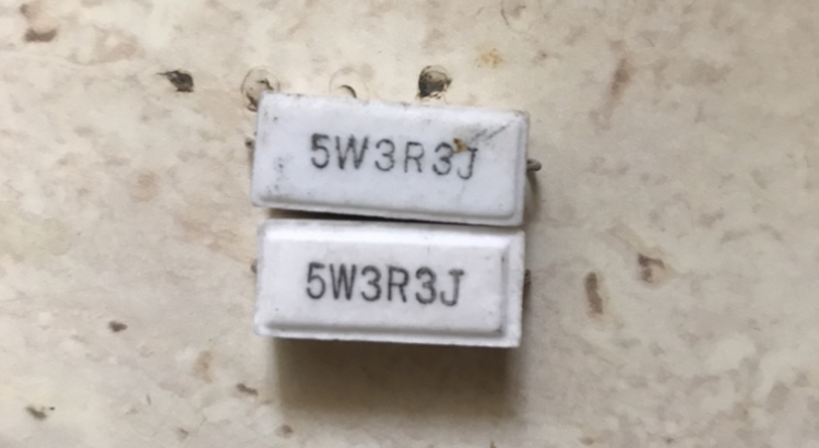

Am pus lpad pe tweeter , sa l reduc de la 105db dupa schema prezentata , dar nu chiar valorile indicate
