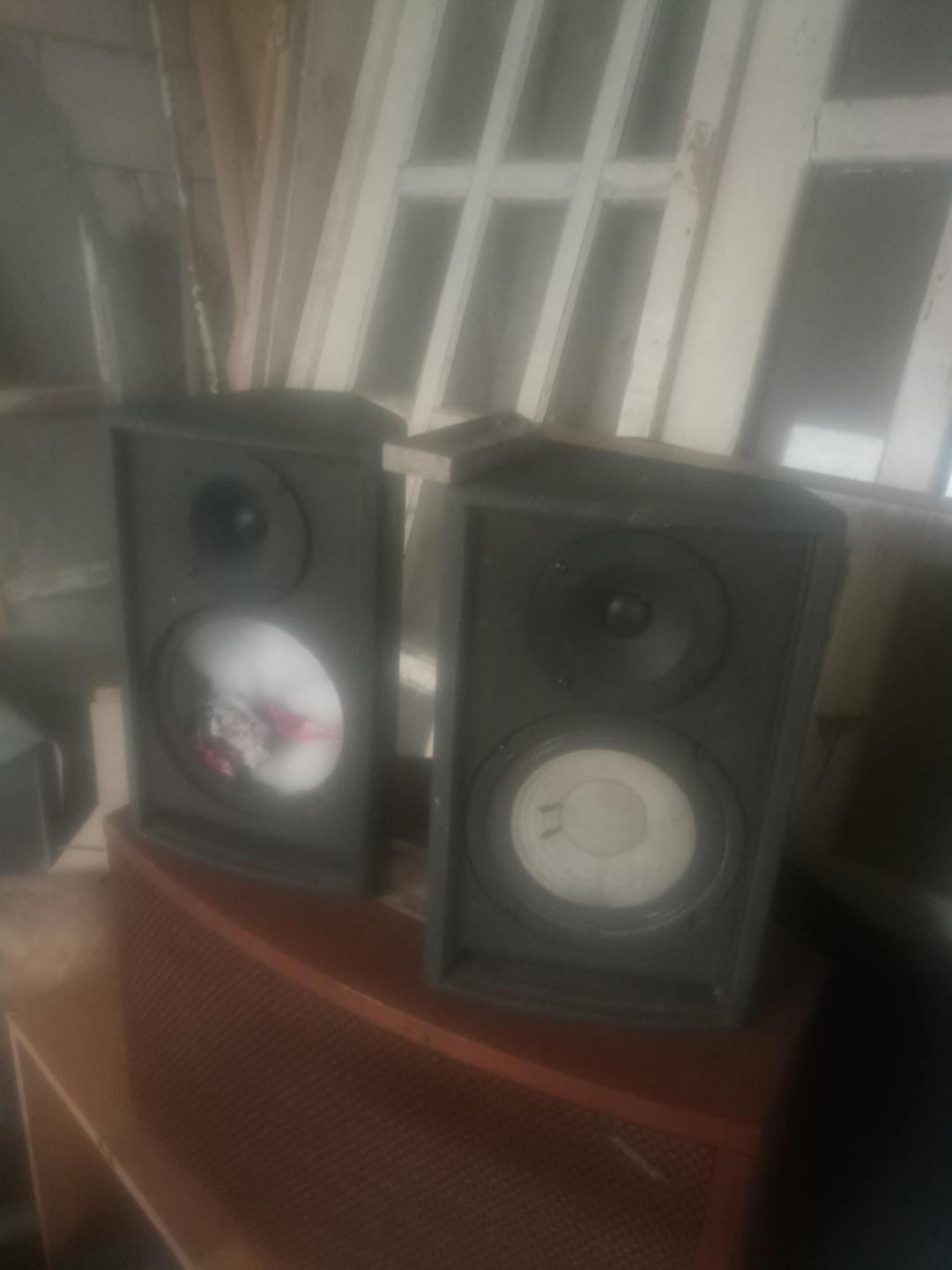

Am primit niste boxe trapezoidale, bass reflex, din lemn stratificat cu 6,5inch+supertweeter(165mm are basul), pe grila era lipita o tablita din aluminiu si scrie Sonivisa, in spate mufe dublate neutrik nl4mpr, au inclusiv flanse pentru stativ.

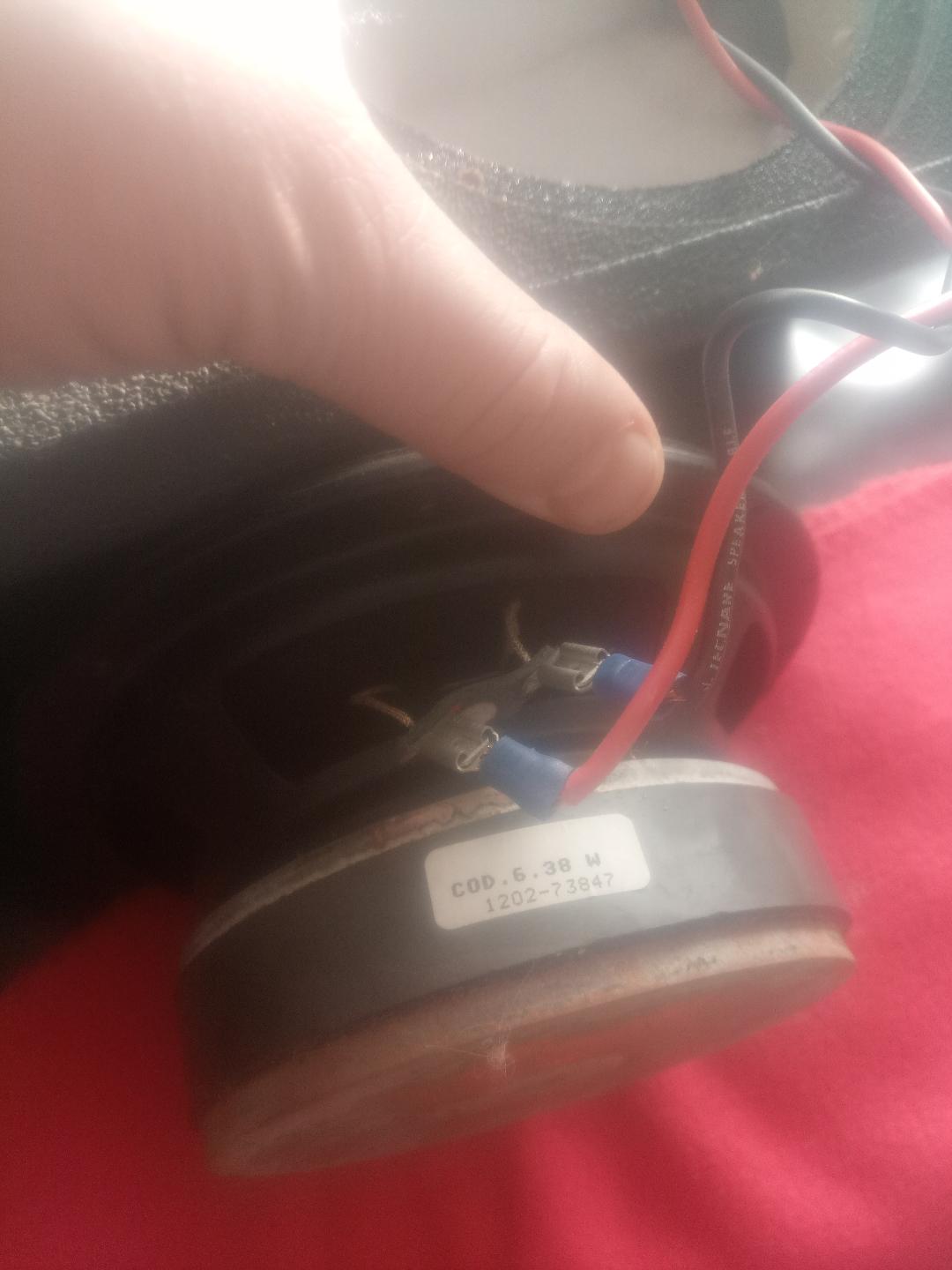

Eticheta bass: COD.6.38 W, 1202-73847
Pare sa semene cu Ciare: http://oem.ciare.com/en/440/350/prodotti.php
Datasheet: http://oem.ciare.com/pdf_oriz_1.php?info=350

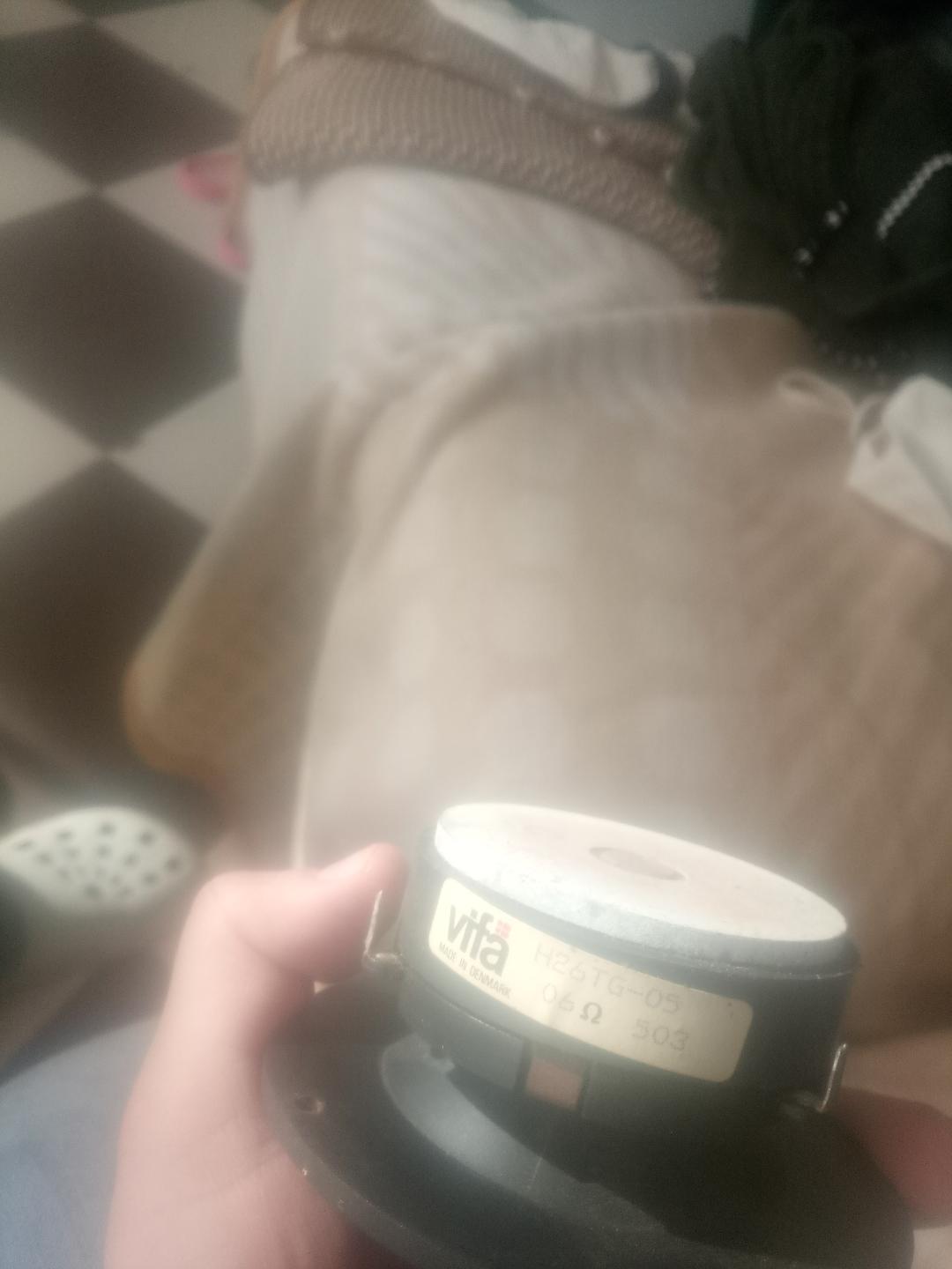

Eticheta inalte: Wifa H26TG-05, 06Ohm 503
Datasheet: https://www.google.ro/url?sa=t&rct=j&q=&esrc=s&source=web&cd=2&cad=rja&uact=8&ved=2ahUKEwiAhKqAgfvgAhWop4sKHaswD9MQFjABegQIBRAC&url=http%3A%2F%2Fwww.madisound.com%2Fpdf%2Fvifa%2Fd26tg-05-06e.pdf&usg=AOvVaw3mOMGGQ8KOxgUQOeUQr3ks

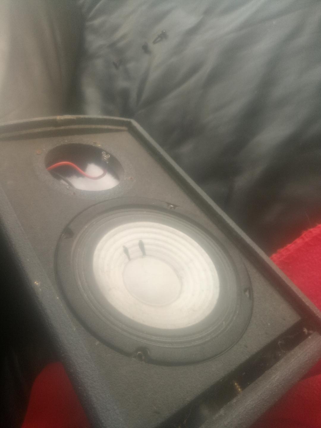

Una dintre boxe a suferit o cazatura(asa le-am primit), si s-a blocat bobina in interfier, rupte 2nituri!
Cu ce difuzoare sa inlocuiesc cele de 6,5inch? Oare merita reparate? Unul merge. Sunt putin oxidate.
As putea pune Faital pro 6FE200?
https://www.poweraudio.ro/difuzoare_profesionale/faital_pro_6fe200_8ohmi?filter=13,12

Am trimis azi un mail la Ciare, adresa luata de pe site-ul lor, sa verific daca chiar difuzorul le apartine. Merita sa incerc.
"Hi,
I need speaker replacement for my Sonivisa F-6S speakers, because one of the speakers where falling down and magnet unglued from assembly.
Inside in the box, there is a label with COD.6.38W and code 1202-73847 – see below picture and I think is speaker produced by Ciare : 6.38W. Can you confirm this? Do you recognize this product?
I’m located in City Timisoara, Romania. How and from where I can buy replacement speakers? I need pair of them. Please support.
Raspunsul lor si de acolo concluzia, se pare ca era un difuzor custom made cu Fs 66Hz - vezi atasament.
"Dear Mr. Topciov,
we can confirm that this is a Ciare speaker, but unfortunately it is very old custom one and we have no way to provide it now because is no longer made for a long time.
We can only suggest to consider the replacement with the model PM160 that is a very similar model, but not identical, attached you find the datasheet.
At the moment we don’t have a distributor in Romania, so for to buy 2 pieces only I suggest to find on the web a reseller that can ship directly to you from Italy.
