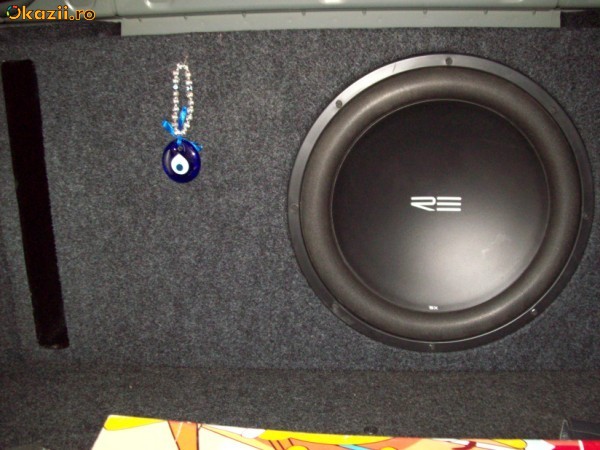

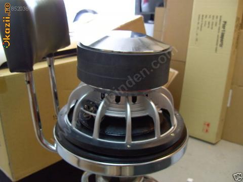

Sizes: 15" ( Dual 4 ohm)
• Dual Composite 2-piece Cone
• Rubatek Foam Surround
• Cast Aluminum Basket
• Tork-Tite Terminal
• 3 " 8-layer Aluminum Voice Coil
• FEA Optimized Motor Structure
• Triple Stack Magnets
• Progressive Spiders
• Wrap around Rubber Gasket
SX SERIES
T/S Parameters
15"
Electrical Q Value -Qes: 0.38
Mechanical Q Value -Qms: 4.7
Total Speaker Q Value -Qts: 0.38
Free Air Resonance -Fs: 27.8 Hz
Equivalent Compliance -Vas: 126.3 liters
One-Way, Linear Excursion -Xmax: 22 mm
Efficiency -SPL 1W/1m: 90.4 dB SPL
Effective Piston Area -Sd: 810 cm^2
DC Resistance -Re: 1.9 ohm
Nominal Impedance -Znom: Dual 2/4 ohm
Thermal Power Handling -Pe: 1000 W
Force Factor -Bl: 21
Made in USA
248731783-4639921-700_700.jpg [ 29.46 KiB | Vizualizat de 5181 ori ]
248731782-4639921-700_700.jpg [ 72.77 KiB | Vizualizat de 5181 ori ]
 Subiectul mesajului: Re: INTREBARE
MesajScris: Vin Ian 07, 2011 6:58 pm
deci sa inteleg ca difuzuzorul tau are 2 bobine de 4 ohmi
cam care este bugetul alocat pentru amplificator/amplificatoare
