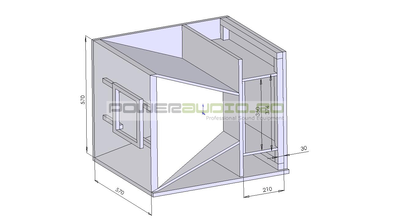

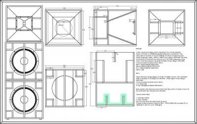

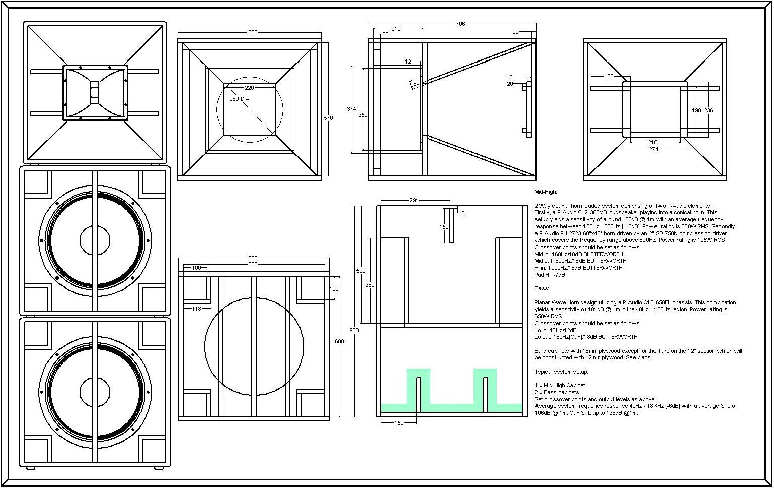

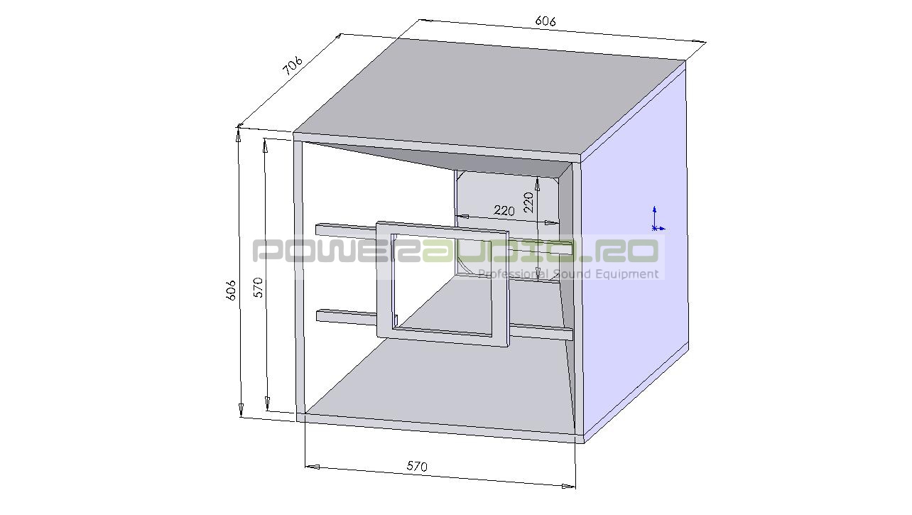

 Subiectul mesajului: Proiect satelit coaxial 12 inch+2 inch hornloaded-FX12
MesajScris: Dum Noi 21, 2010 7:07 pm

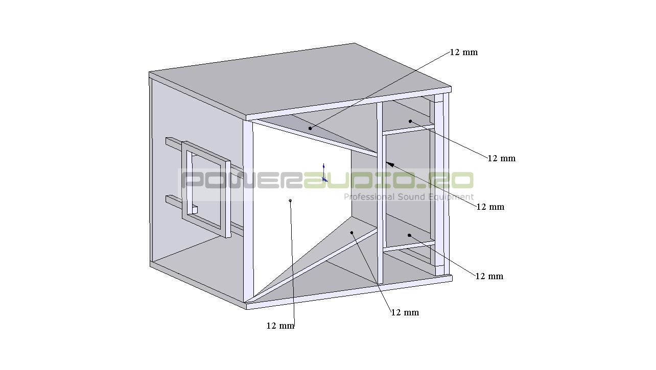

Material folosit 18mm+12mm
Proiect original.jpg [ 226.68 KiB | Vizualizat de 53652 ori ]
ansamblu.jpg [ 129.2 KiB | Vizualizat de 53652 ori ]

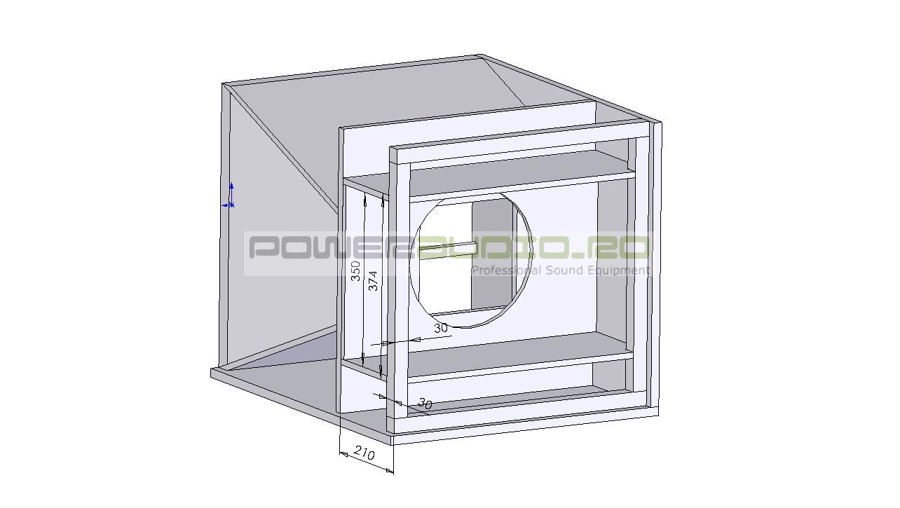

detalii interioare.jpg [ 171.89 KiB | Vizualizat de 53652 ori ]
detalii interioare 2.jpg [ 164.46 KiB | Vizualizat de 53652 ori ]
detalii grosime material.jpg [ 149.99 KiB | Vizualizat de 53652 ori ]

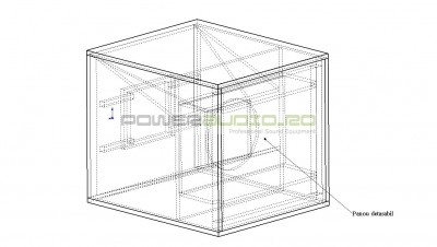

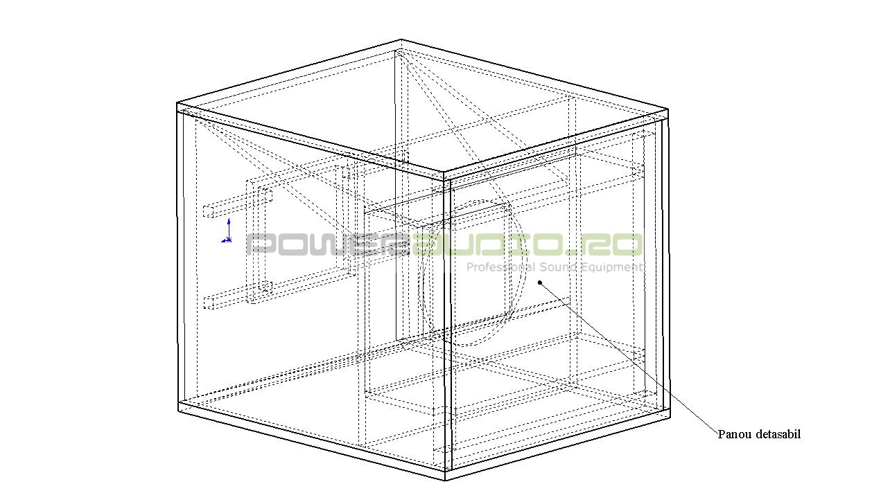

panou detasabil.jpg [ 318.56 KiB | Vizualizat de 53652 ori ]

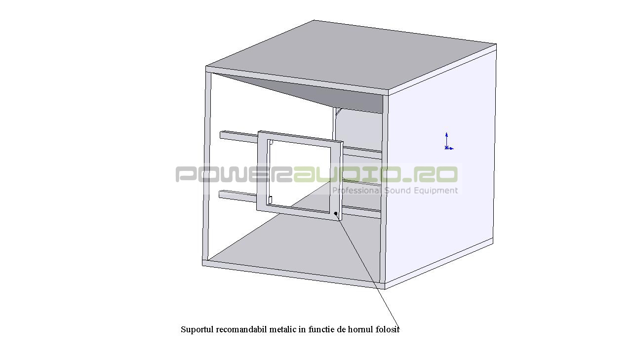

detaliu suport horn driver.jpg [ 122.5 KiB | Vizualizat de 53652 ori ]

 Subiectul mesajului: Re: Proiect satelit coaxial 12 inch+2 inch hornloaded-FX12
MesajScris: Mar Aug 13, 2019 6:27 pm
Membru din: Mar Aug 13, 2019 6:15 pm
Mesaje: 4

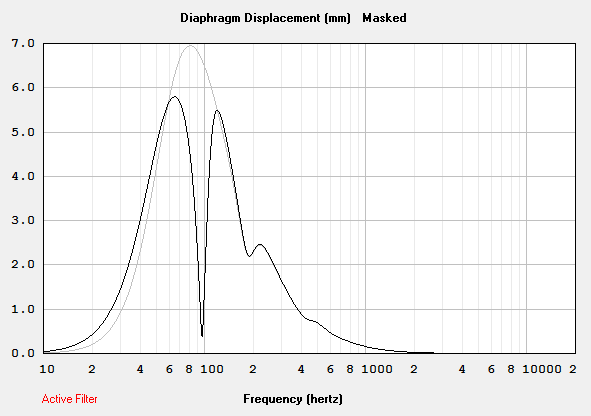

Hi, folks.
There are a phase-inverting port can be added in mid-cabinet design.
160 sq cm area and 8 cm depth outside of mouth.
It will ventilate rear chamber and allow more power headroom.
Poweraudio_midhorn.PNG [ 19.89 KiB | Vizualizat de 24501 ori ]

Can you also post a displacement graph at 500W?

Hi, Mircea!
Of course, let’s choose the driver itself.
Recommended?
Well-known performer 12MB650?
Or something extreme like MB12N405?
And let me know about possibility to optimize rear chamber volume based on driver performance. This will not interfere with design outline, only inner braces placement.

MesajScris: Joi Aug 15, 2019 9:23 am
choose any driver you like
the reason is that I want to compare the displacement graph between the 2 situations (with and without port)
also, the port will add extension but that won't really make such a big difference. The horn mouth will become directive after a retain frequency. Pattern control will be absent in the frequency band that the port acts so it's better to have that extension provided by dedicated speakers than to force the midbass from the midhorn that low.
for small events it is a solution but as the number of speakers increases the port won't make such a big difference.
Also group delay will suffer and you will have phase issues which will make the sound muddy. This is one of the main reasons I'm not a big fan of porting horns
Ok, 12MB650. 600Wt/8Ohm
I've placed optimistical 60 Hz LR24 filter and then tune port freq to that of the maximum displacement.
Pattern control of that size mouth becomes directive not less than 350 Hz, so adding extra lower end response are needed mostly to obtain "fast punchy" kick from the midbass driver with lower Mms/Bl ratio than subwoofer.
Yes. There will be choose for builder:
1. Precise response, but lower power headroom and less mid-bass response. I'ld prefer that for smaller venues
2. A little harder for align ported enclosure, but more power headroom and punchy "kick".
12MB650_displ.PNG [ 19.54 KiB | Vizualizat de 24434 ori ]

every speaker has some compromises in the end. so it's either limited low end response with better clarity
or a better low end extension with some loss of clarity.
It really depends on the style of music played trough the system
for high quality live vocal applications no port would be better
For electronic music , disco, etc port would be usefull
Or a huge DSP...
:wink:
One active/DSP-based all-pass filter mostly eliminates port phase inversion and restores phase and group delay to a closed box one.
Of course with the same mechanical damping provided, so Qts must be +- equal.
There are no way since one comes to dedicated speaker enclosures or line array.
