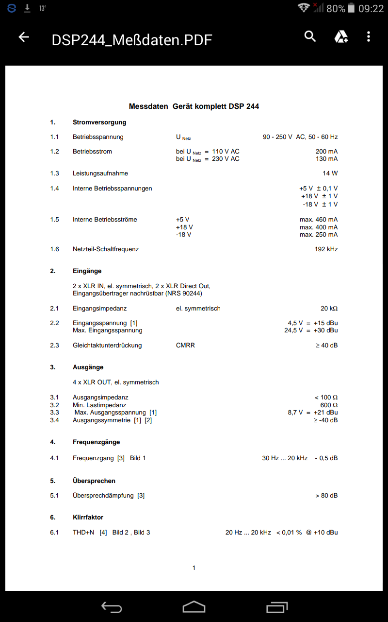

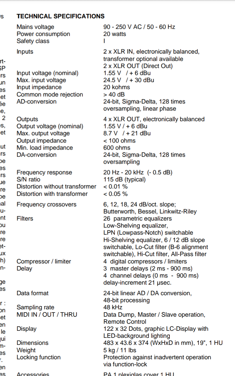

MesajScris: Mie Apr 25, 2018 8:18 am
Printscreen :
Screenshot_2018-04-25-09-27-32.png [ 489.52 KiB | Vizualizat de 4373 ori ]
Screenshot_2018-04-25-09-22-19.png [ 155.07 KiB | Vizualizat de 4373 ori ]
