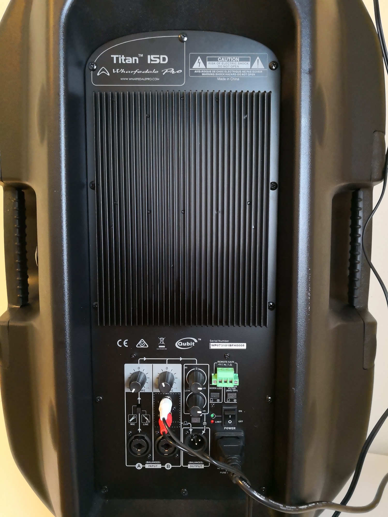

Boxa activa WharfedalePro TITAN 15D
Specifications
INPUT SENSITIVITY: MIC -40dBu / LINE 0dBu
INPUT IMPEDANCE: Balanced 20k? / Unbalanced 10k?
HUM AND NOISE: -90dB
MAXIMUM INPUT LEVEL: +20dBu
DIMENSIONS (HXWXD): 556mm x 384mm x 312mm / 21.88" x 15.11" x 12.28"
EQUALIZATION: HIGH (±10dB) 10KHz Shelving, LOW (±5dB) 100Hz Shelving
GROSS WEIGHT ( KG / LBS ): 27.7kg / 60.94lbs
FINISH COLOUR: Black
AMPLIFIER PROTECTION: Power switch on/off mute; DC detection; Overload & short-circuit detection; Thermal/Heat sink protection; Output mute/reset
LOW FREQUENCY POWER: 350W RMS
HIGH FREQUENCY POWER: 70W RMS
MONITOR FILTER: A 90Hz HPF Filter for stage monitor use.
REMOTE GAIN ATTENUATOR: 3 pin Euroblock connector for remote volume adjustment.

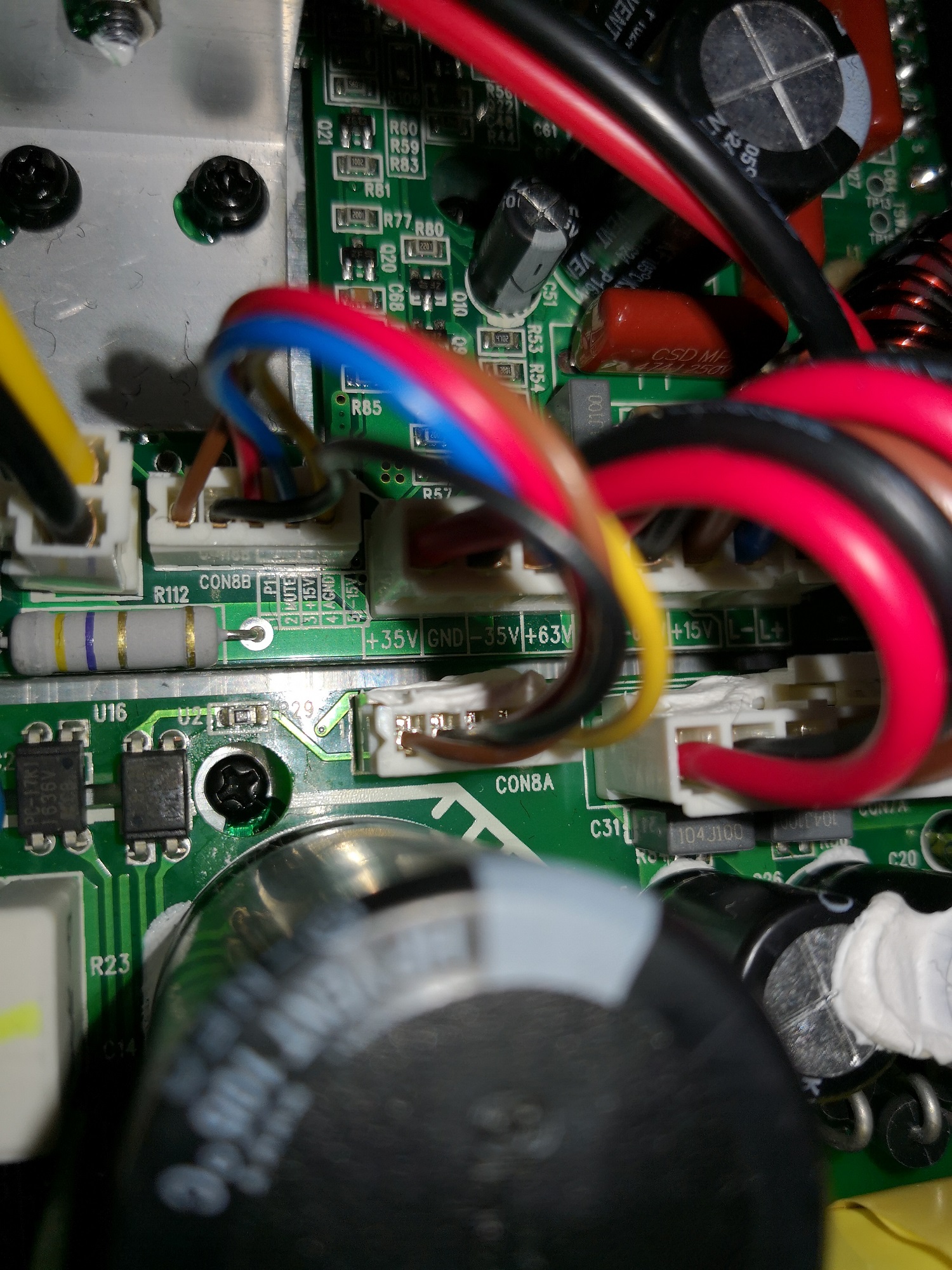

Comentariu fişier: Tensiuni de alimentare amplificatoare: +/-35V HF (amplificator clasa AB) si +/-63V LF (amplificator clasa D)

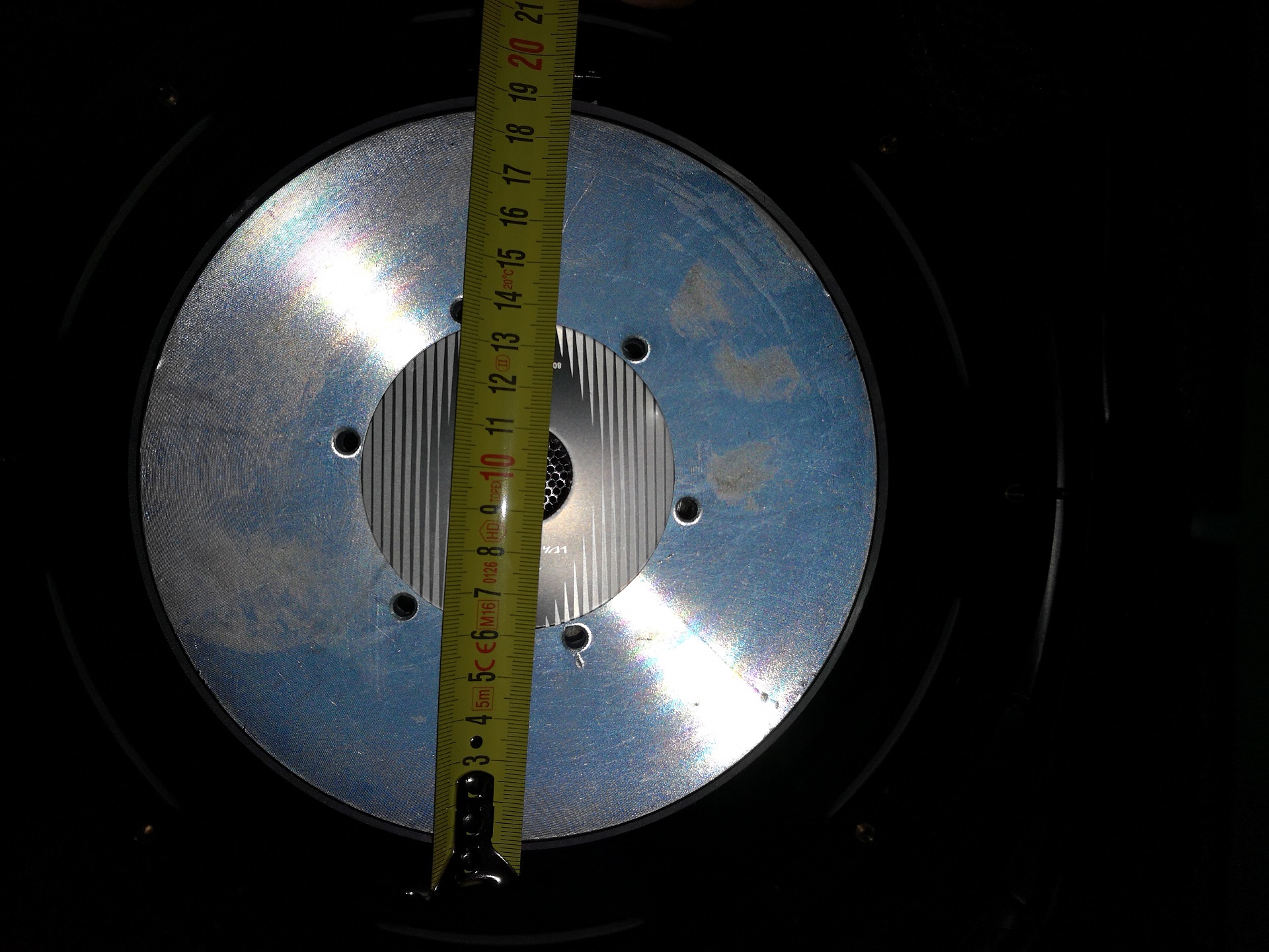

Comentariu fişier: Diametru magnet difuzor 18cm, bobina de 75mm (3")
IMG_20180525_190115.jpg [ 622 KiB | Vizualizat de 4410 ori ]

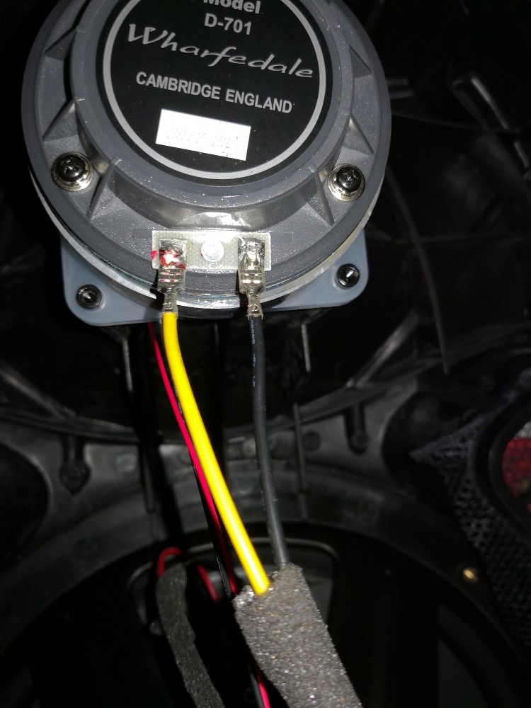

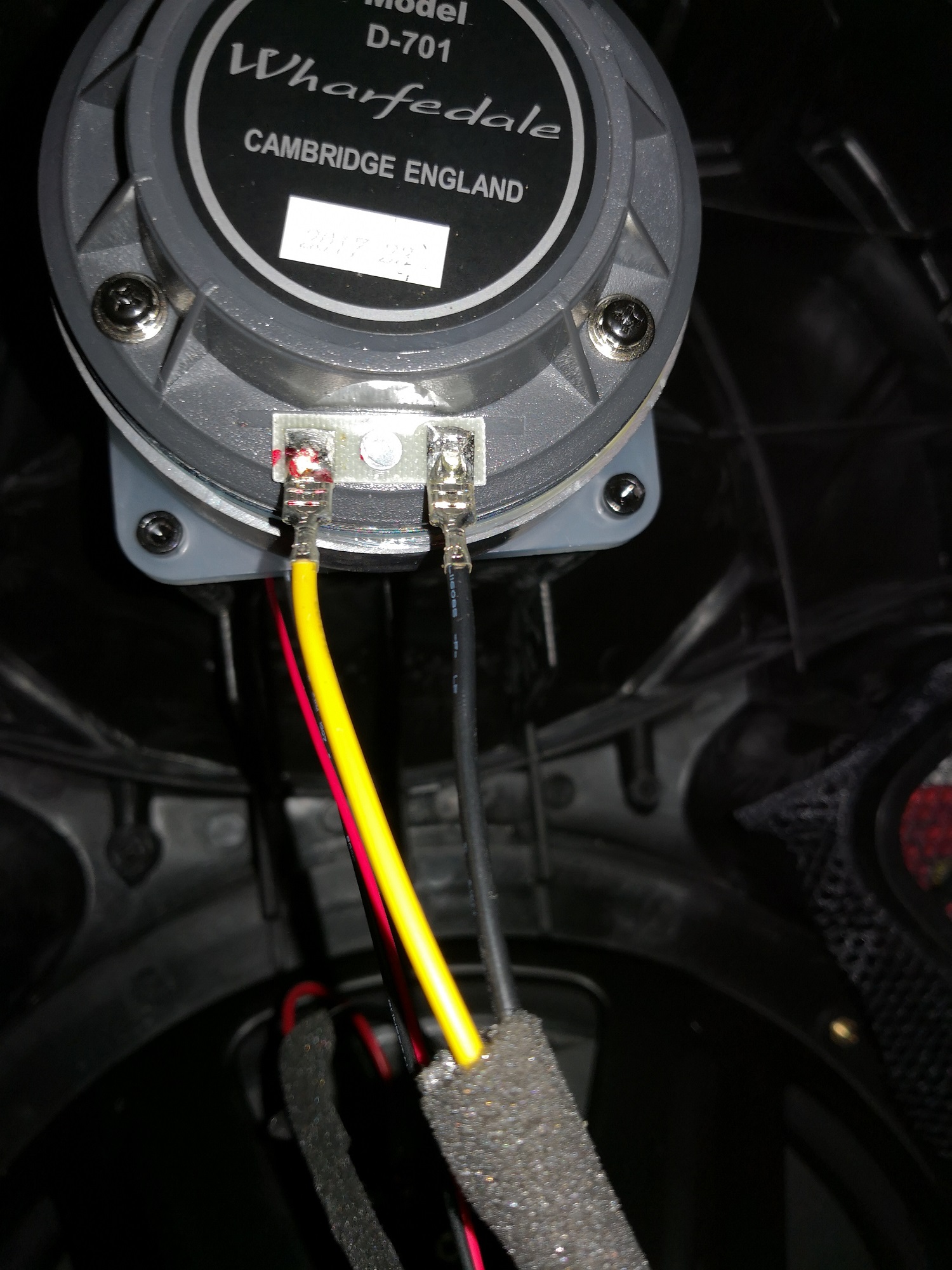

Comentariu fişier: Driver, model D-701 Wharfedale, 8 ohmi
IMG_20180525_185649.jpg [ 616.1 KiB | Vizualizat de 4410 ori ]

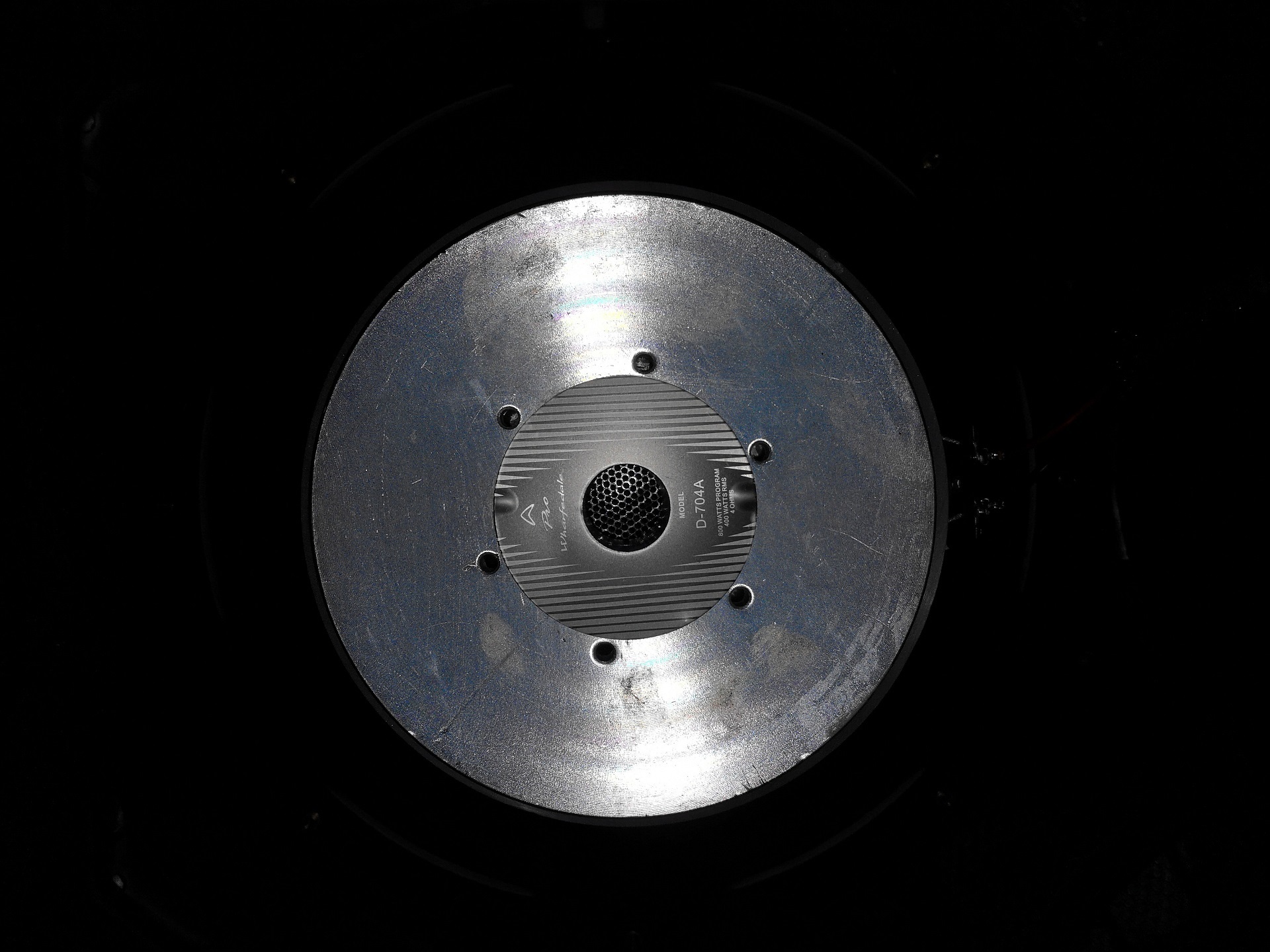

Comentariu fişier: Difuzor de bass, model D-704A, 4 ohmi
IMG_20180525_185624.jpg [ 513.69 KiB | Vizualizat de 4410 ori ]

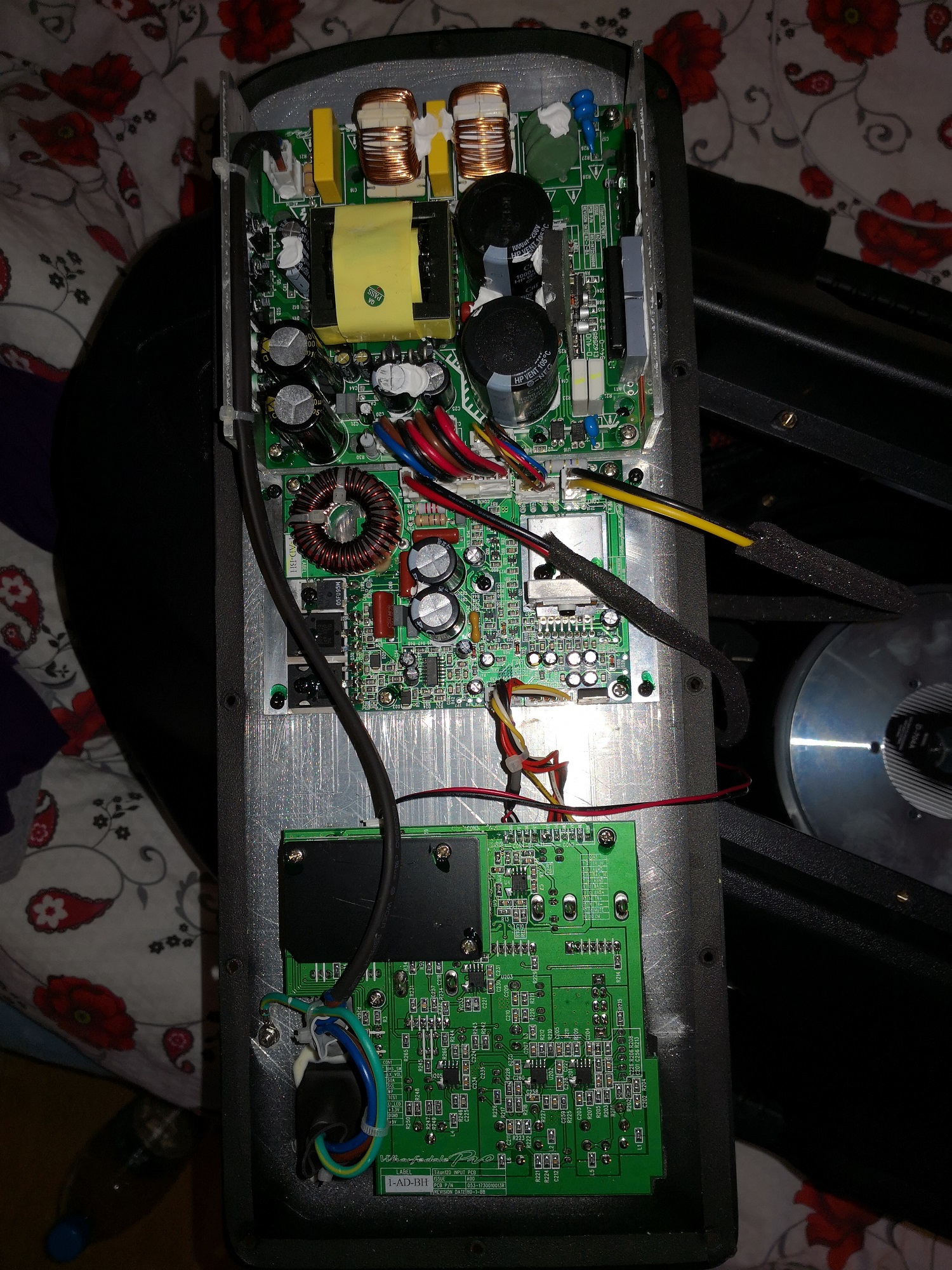

Comentariu fişier: Modulul de amplificare si sursa SMPS

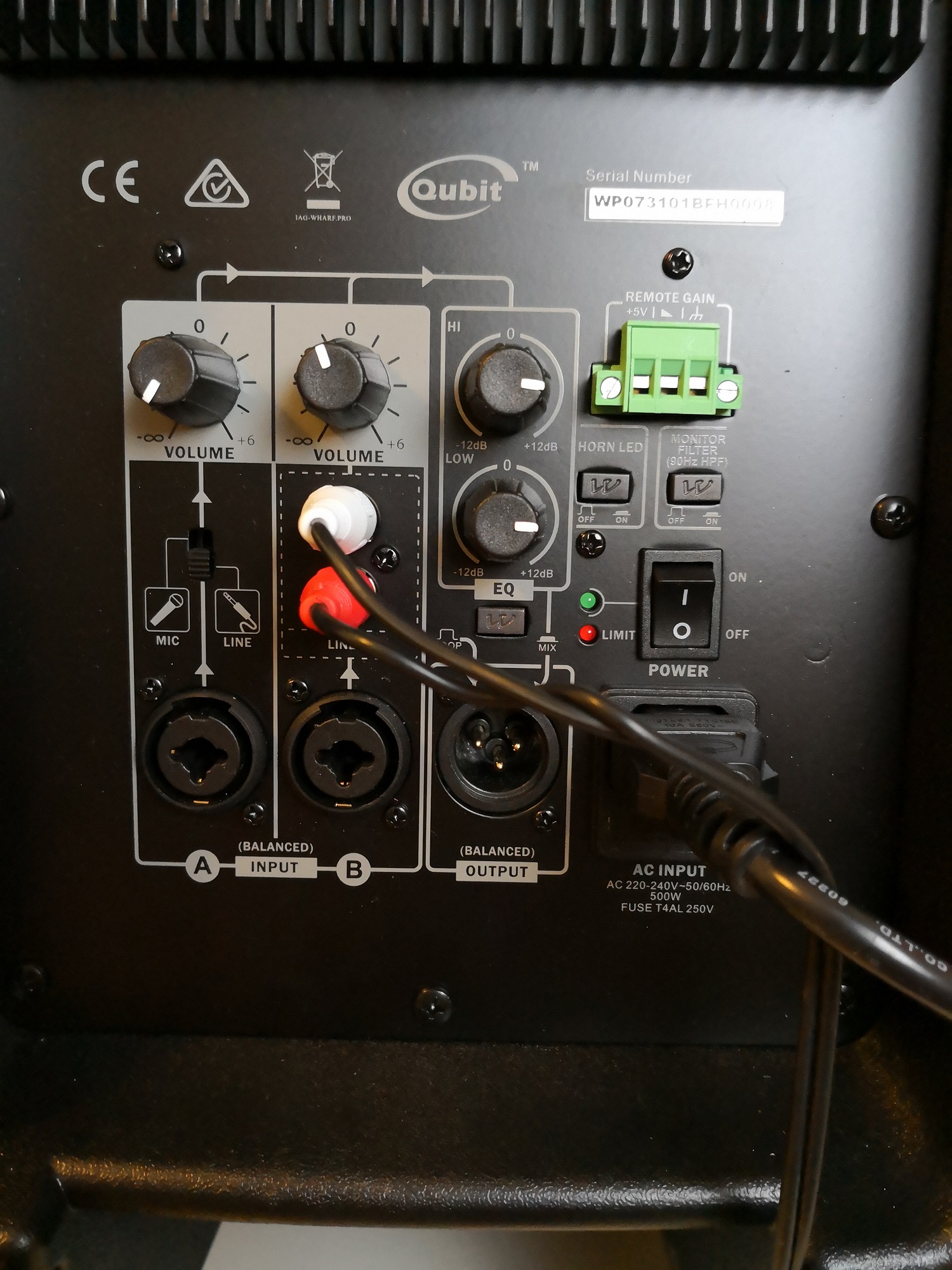

Comentariu fişier: Consum 500W, siguranta T4AL 250VAC
