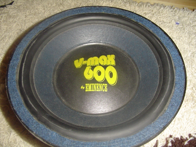

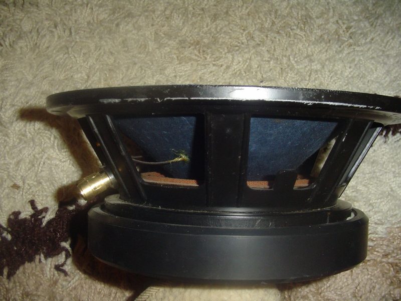

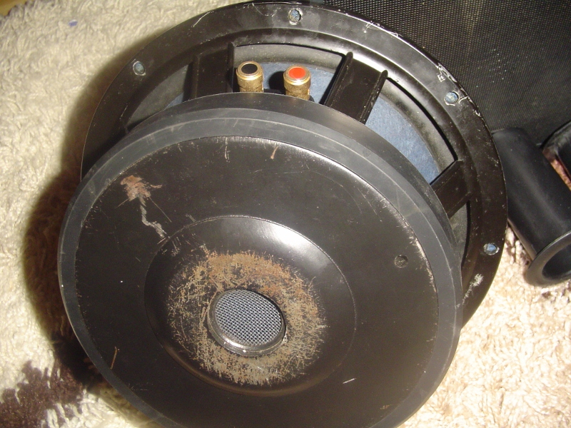

Detin 2 difuzoare Eminence Vmax 600 de 10" ( O serie foarte scurta pt auto ) si ma gandesc sa fac cu ele 2 subbasi ceva mai interesanti ( horn, planar , folded horn...)
Parametrii:
05-RE OHMS 3.27
06-LE MH .68
07-QM 9.93
08-QE .630
09-QT .600
10-XMAX MM 4.60
11-BL TM 7.65
12-EFF % .60
13-FS HZ 41.83
14-MMS GMS 43.16
15-CMS mm/N .3354
16-RMS NS/M 1.1425
17-VAS LTRS 54.36
18-SD SCM 339.67
19-EBP 65.9
20-SPL dB 89.8
Ce constructie ar obtine cel mai performant subbass ?
