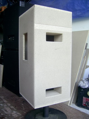

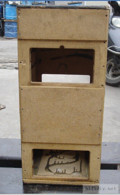

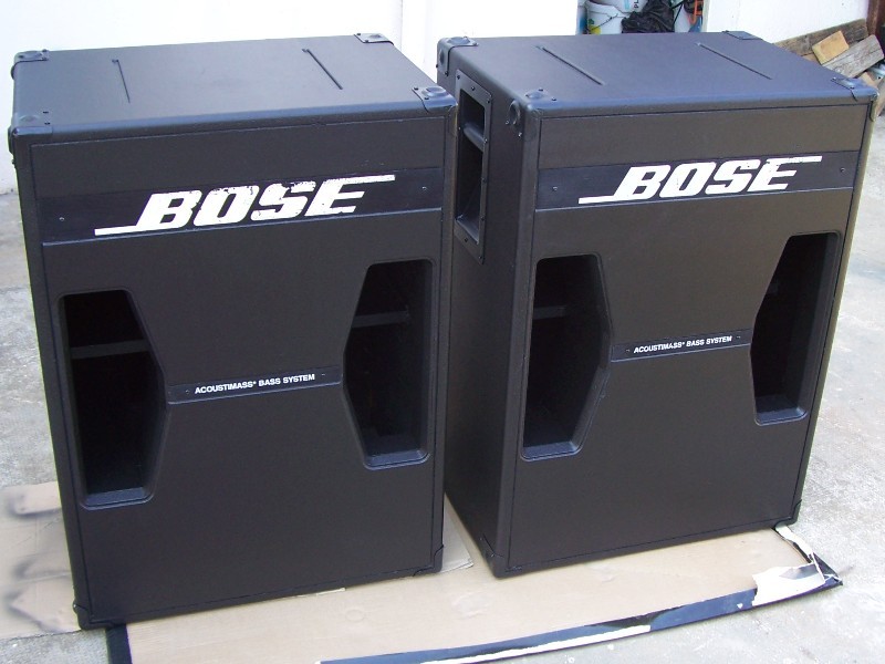

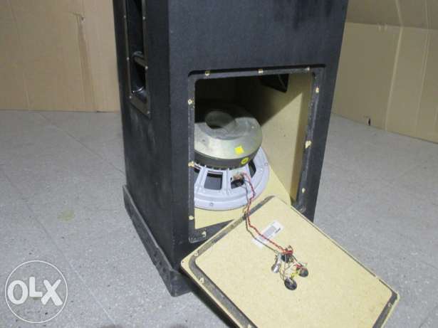

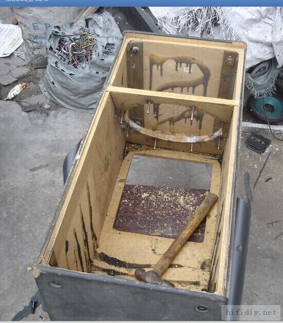

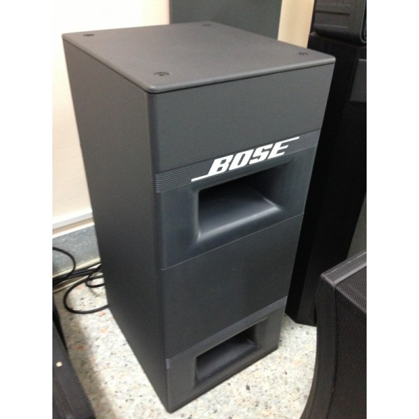

Salut!!! As vrea sa intreb daca a mai facut cineva modelul asta??
Bose502 am o mare problema nu gasesc dimensiuni si nici parametri din ce am vazut au difuzoare cu membrana de cauciuc,nu am nici o ideie, am ales modelul asta pt ca sunt mai mici suficient pt cat am nevoe fata de bose 302 la modelul 302 am gasit parametri o sa atasez imagini la ambele modele
Apreciez fiecare informatie Multumesc !!!!

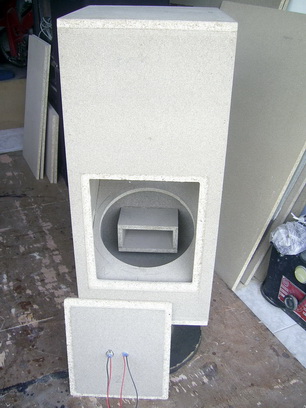

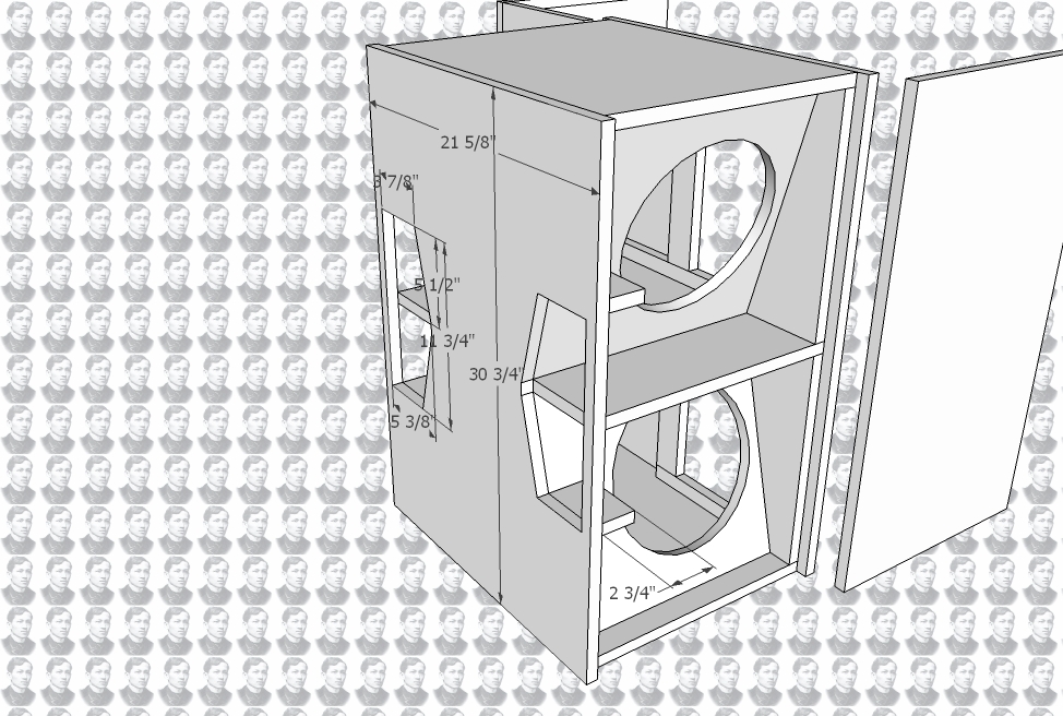

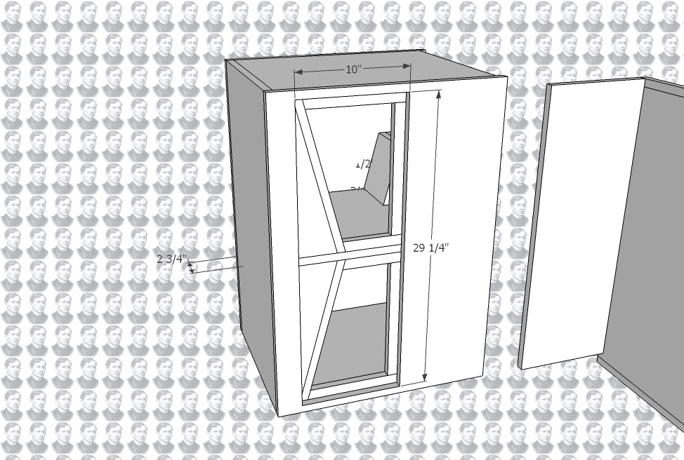

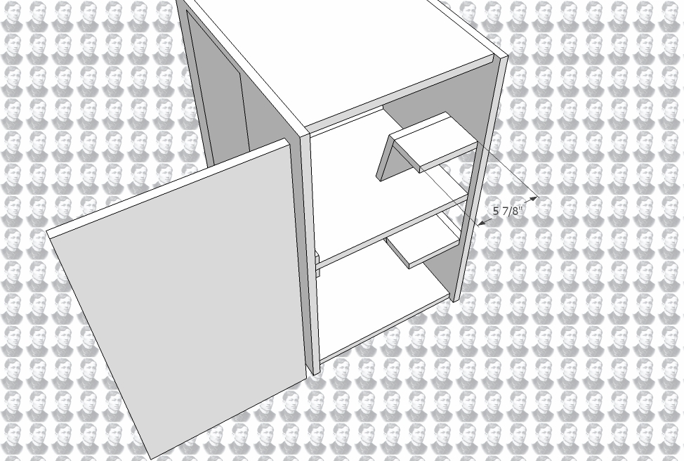

Continuare la modelul 502

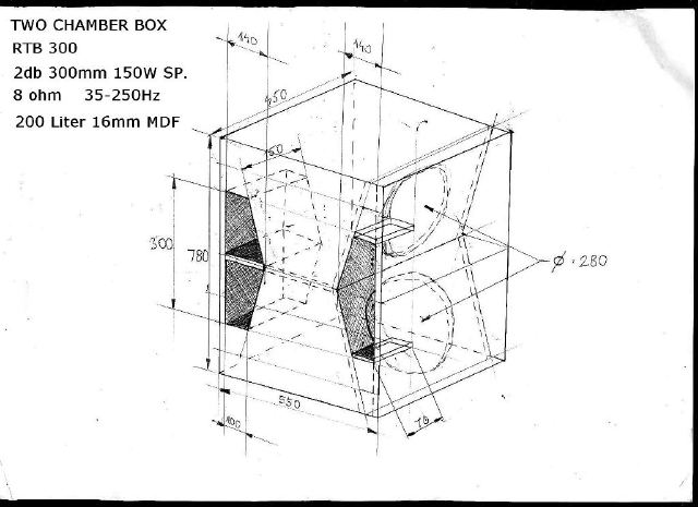

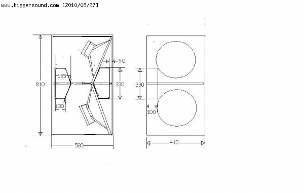

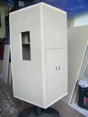

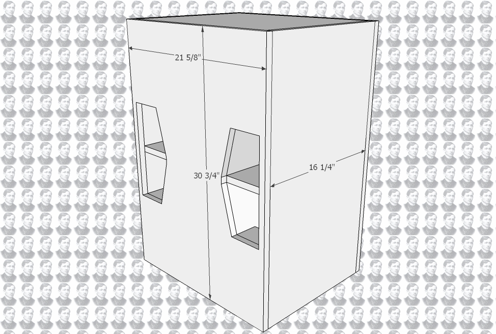

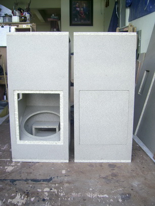

Planuri model BOSE 302

La modelul 502 ma gandeam sa optez pt ceva difuzoare auto Ground Zero Hydrogen GZHW-12SPL,JL10W6v3-D4 ,Hertz Hi Energy HX 250 D.5 pe diametru de 25 cm dar sunt constient ca va trebui sa modific si incintele si nu cred ca imi va fi usor sa scot cel mai bun si frumos bass. Nu de alta dar nici nu ma prea pricem am ceva informati de baza. In cea ce priveste modelul 302 nu stiu nici acolo ce difuzoare as putea pune,am remarcat in planuri ca au difuzoare cu diametrul de 28 cm si nicici nu ma prea incata 2 cuti mari si grosolane in living......

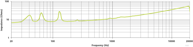

Am revenit cu ceva date.

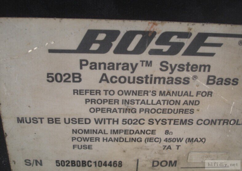

Technical Summary
Frequency Response (+/-3 dB)
50 Hz – 140 Hz
Frequency Range (-10 dB)
45 Hz – 160 Hz
Nominal Dispersion
Omni-directional below 200 Hz
Long-Term Power Handling
450 W (1800 W peak)
Sensitivity (SPL / 1 W @ 1 m)
90 dB SPL
Maximum SPL @ 1 m
116 dB SPL (122 dB SPL peak)
Nominal Impedance
8 Ω
Key Features
Single 12″ (305 mm) woofer with Bose® patented Acoustimass® speaker technology, which reduces audible distortion and delivers non-localized bass
450 W long-term and 1800 W peak power rating
Integrated suspension inserts allow easy permanent installations with optional rigging accessories
Engineered to match acoustically with the Panaray 502 A speaker systems
Applications
Houses of worship
Auditoriums
Restaurants and bars
Hotels
Atriums and malls
Foreground music
Physical
Enclosure
Vinyl-wrapped, high-density wood composite
Environmental
Indoor use only
Connectors
Two (2) parallel-wired barrier strips
Suspension / Mounting
Eight (8) 8 mm threaded inserts (4 top, 4 bottom), 20 mm depth
Dimensions
31.0″ H x 14.0″ W x 15.5″ D (787 mm x 356 mm x 394 mm)
Net Weight
85 lb (38.6 kg)
Color
Grey, White, Paintable
Package Contents
1 loudspeaker
Specificati:
System Performance
Frequency Response (+/-3 dB) 1 50 Hz – 140 Hz
Frequency Range (-10 dB) 1 45 Hz – 160 Hz
Nominal Dispersion Omni-directional below 200 Hz
Loudspeaker EQ Required
Overload Protection 7-ampre AGC or 3AG (Littlefuse)
Long-Term Power Handling 2 450 W (1800 W peak)
Sensitivity (SPL / 1 W @ 1 m) 3 90 dB SPL
Maximum SPL @ 1 m 4 116 dB SPL (122 dB SPL peak)
Nominal Impedance 8 Ω
Transducers
Driver Compliment 12″ (305 mm) woofer
Physical
Enclosure Vinyl-wrapped, high-density wood composite
Grille -/-
Environmental Indoor use only
Connectors Two (2) parallel-wired barrier strips
Suspension / Mounting Eight (8) 8 mm threaded inserts (4 top, 4 bottom), 20 mm depth 31.0″ H x 14.0″ W x 15.5″ D (787 mm x 356 mm x 394 mm)
Dimensions 31.0″ H x 14.0″ W x 15.5″ D (787 mm x 356 mm x 394 mm)
Net Weight 85 lb (38.6 kg)
Shipping Weight 88 lb (39.8 kg)
Product Code
Grey 040090
White 040091
Footnotes:
Frequency response and range measured on-axis with recommended active EQ in an anechoic environment.
Power handling tested using pink noise filtered to meet IEC 268-5, 6 dB crest factor, 100 hours, with recommended EQ.
Sensitivity measured in free field (no boundary-loading gain) with recommended active EQ, referenced to 1W/1m.
Maximum SPL calculated from sensitivity and power handling specifications, exclusive of power compression.
Architects’ & Engineers’ Specifications
The low-frequency device shall be a dual-ported highly compact enclosure with matched active equalization as follows:
The transducer complement shall consist of one (1) high-power-handling driver of 12″ (305 mm) diameter, mounted inside an enclosure such that distortion is minimized as a result of acoustic filtering. Its operating frequency range shall be below 160 Hz so that non-localizability shall allow a high degree of location placement flexibility.
The input connector, located on the rear of the enclosure, shall be a screw-type barrier strip.
The enclosure shall be made of vinyl-wrapped, high-density wood composite, with outer dimensions of 31.0″ x 14.0″ x 15.5″ (787 mm x 356 mm x 394 mm); its weight shall be 85 lb (38.6 kg).
The bass enclosure’s maximum continuous acoustic output shall be 116 dB SPL from 50 Hz to 140 Hz, with measurements referenced to a full-bandwidth pink-noise input at 1 meter at the enclosure’s rated power. Its power-handling capacity shall be 450 watts continuous referenced to IEC noise for 100 hours.
The bass enclosure shall be the Bose® Panaray® 502® B Acoustimass® enclosure.
Asta e tot ce am .......... :oops: :oops: :oops: :oops: :oops: :oops: :oops:

bose foloseste niste difuzoare OEM
nu sunt modele de serie
daca vrei sa reproduci un proiect de al lor si sa folosesti cu totul alte difuzoare... e munca in zadar
tinand cont ca vorbim de proiecte band-pass cu atat se complica mai mult lucrurile
cu difuzoare auto vei obtine un group-delay mare care se va traduce printr-o huruiala puternica pe partea de bas
per-ansamblu eu il vad ca pe un esec
daca vrei sa scoti tot ce se poate din difuzoarele alea - mergi pe proiectele recomandate de producatori

daca bine retin, bose folosea si niste controllere dedicate pentru boxele lor, asa ca pe langa lipsa difuzoarelor corecte te vei mai lovi si de lipsa controllerelor.
In realitate nu sunt altceva decat niste incinte bandpass de ordin 6.
Daca doresti ceva pentru acasa , poate ca ar fi o idee mai buna sa cauti niste difuzoare hi-fi de calitate, Perless, Vifa, etc si sa-ti construiesti niste incinte inchise pentru ele.

teoretic nu ar fi o problema sa simulam un difuzor intr-o incinta bandpass dedusa dintr-un proiect bose

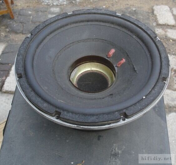

Difuzoarele de joase ( subwoofer ) sunt produse de Eminence , OEM iar cele de bandă largă ( satelit ) sunt produse de Celestion , evident OEM .
Schemele procesoarelor analogice Bose sunt postate în secțiunea de profil ...
Sub-ul 302 merită ceva mai multa atenție , dar 502 nu .
502-ul este un upper bas , în genul lui HD15 , dar cu o întârziere cât China , chiar și procesat .
302-ul este un caz particular , un fel de Rolls Royce în lumea duo-chamber- elor , iar pentru originalul 302 am doar cuvinte de laudă .

res_8d407cf361362e7682113db76680f0e8_full.jpg [ 75.47 KiB | Vizualizat de 6442 ori ]
