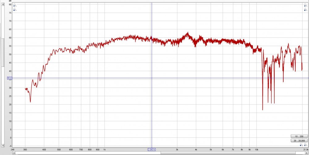

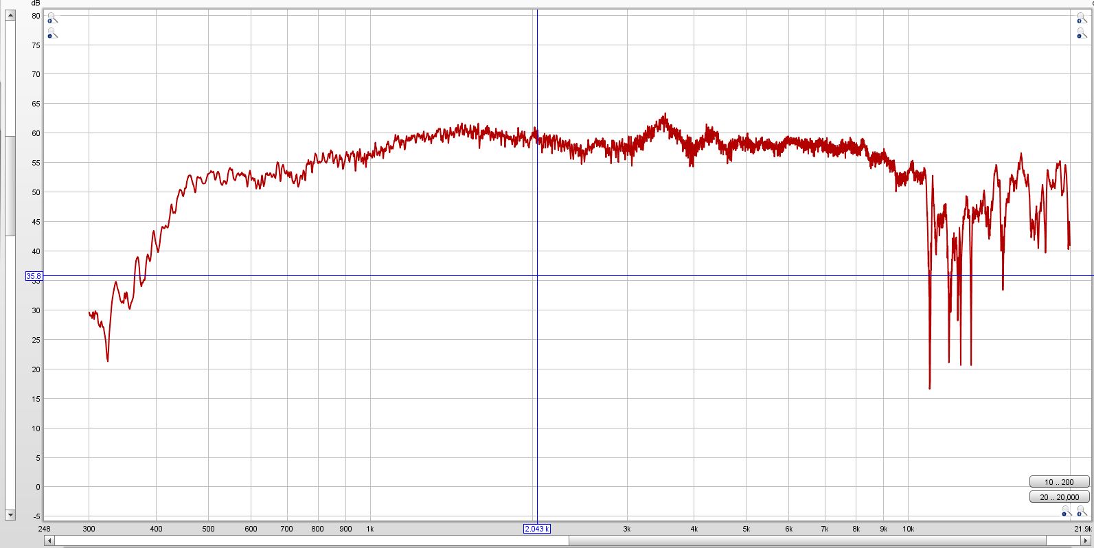

Pentru cine e interesat, postez masuratoare la 30cm la volum de camera auditie normala, stifturi 760Neo 16 ohm in horn
https://www.poweraudio.ro/horn_p-audio_PH-642?search=642
fara EQ, doar un HighPass LR4 200Hz
