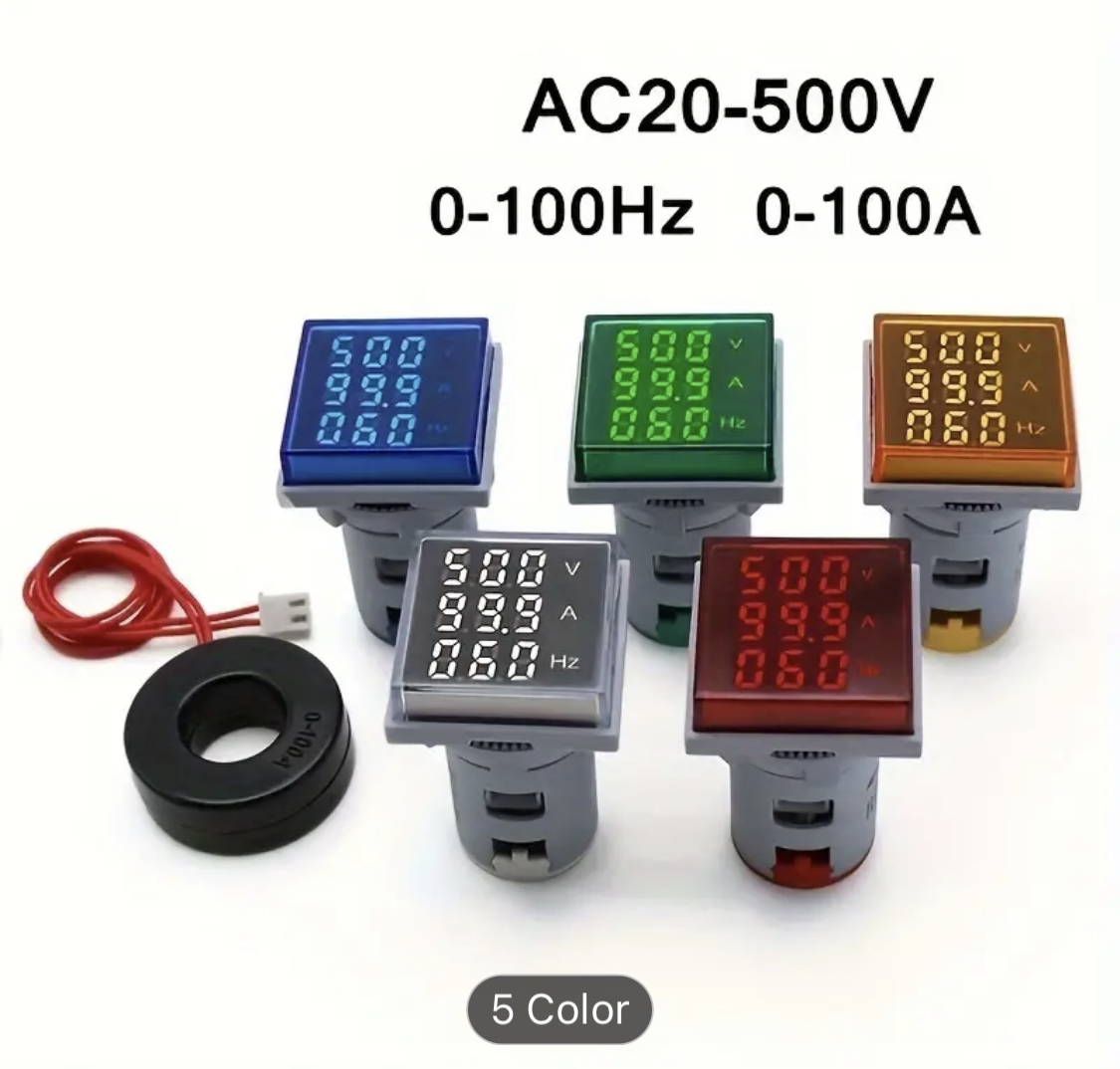

Este un voltmetru hz metru si ampermetru cu traf de masura pe Temu.
Este micut si potriveste exact intr-o gaura de mufa speakon cum sunt si pe panourile de rack ;)
Am doua bucati cumparate. Inca nu le-am testat, doar le-am probat ca si montaj.
Iti rezolva problema perfect.

Arata foarte bine, super compact si face exact ce am nevoie.

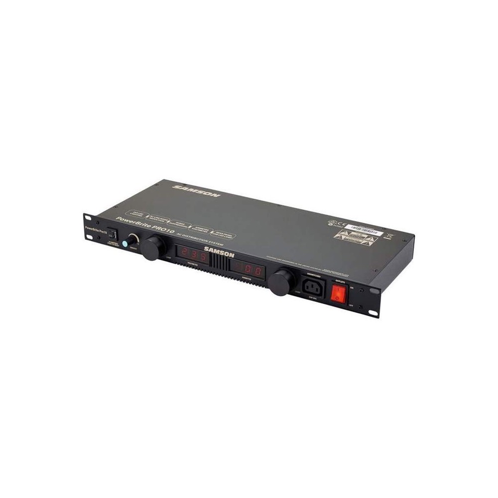

Mai am o intrebare pe subiectul asta. Am vazut la multi in rack-uri, genul asta de aparate (am atasat poza). La ce folosesc mai exact?
Multumesc frumos.

Salut,
Vezi datasheetul producatorului:
https://www.dlxmusic.no/storage/E26A2EA9F685F10FC28753E018B015474DAFC3DEAFB7F3BF99DC9C92FDFDBD4F/51a5ddb7d28a40089a1d69dca295df20/pdf/media/9ea747ab1a784dce8a502beb8467d99c/571318.pdf
Filtru de zgomot de retea, monitorizare, protectie, etc
The Samson PowerStrip PS10, PowerBrite PB10, and PowerBrite PB10Pro all utilize
state-of-the-art technology in power distribution and are engineered to the finest
detail. Here are some of their main features:
• Eight switched, rear panel, IEC outlets that allow you to power an entire rack’s
worth of gear from one source. In addition, an unswitched front panel convenience
outlet is provided for temporary power needs (such as plugging in a guitar
amplifier, soldering iron, etc.).
• 3-point surge protection, spike clamping protection and RF filtering enables all
connected equipment to operate with maximum efficiency and minimal noise.
• Front panel, re-settable, 10 amp circuit breaker protects all connected gear.
• An independent dedicated switch with status light for powering the rear panel
switched outlets.
• In the PowerBrite PB10 and PowerBrite PB10Pro, dual slide out cylinders containing
LED light clusters that illuminate all gear underneath with cool, clear light. In
addition, there is automatic switching for turning on the lamps.
• In the PowerBrite PB10 and PB10Pro, a rear panel USB socket to use with the
included LED gooseneck lamp providing rear rack lighting.
• In the PowerBrite PB10Pro, a front panel voltmeter and ammeter that allow you to
monitor changes in the current drawn from both switched and unswitched outlets.
• All units are designed to be mounted in the top slot of any standard 19” rack, taking
only a single rack space.
• Rugged construction that makes the Samson PowerStrip PS10, PowerBrite
PB10, and PowerBrite PB10Pro eminently roadworthy and extremely reliably in
permanent installation.
