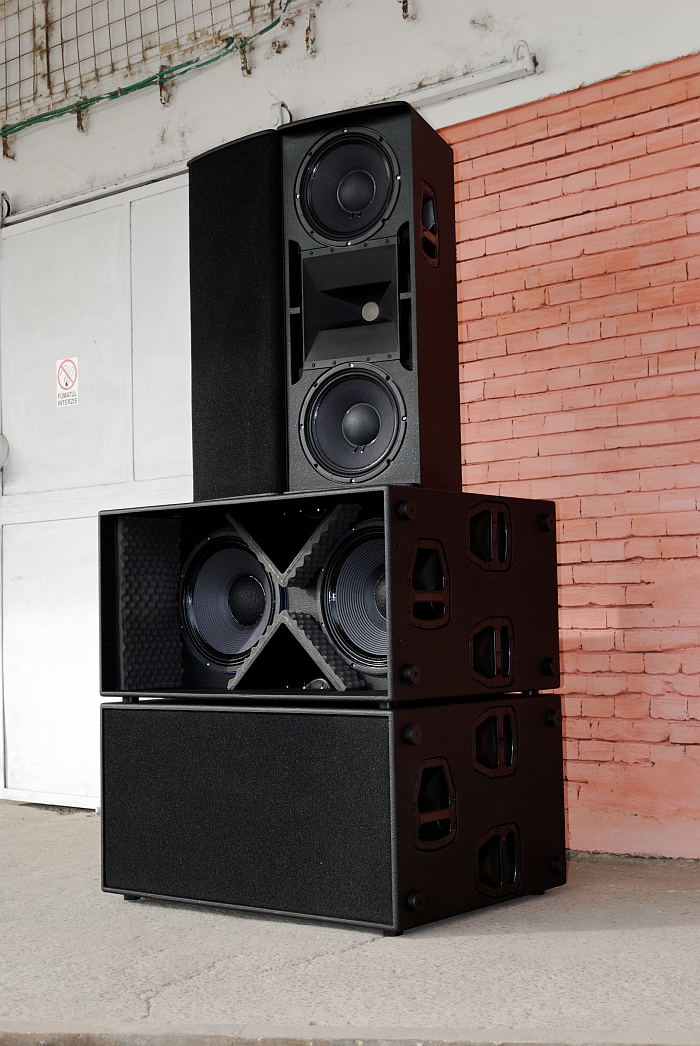

Atasez o imagine cu jumatate din sistem
un stack este compus din 2 subwoofere de 2x15" in planar wave horn hibrid si 2 topuri de 2x12"+2" driver in configuratie d'Apolito.
puterea este de 1600W RMS / subwoofer si 1000W RMS per top
Pretul sistemului compus din 4 subwoofere si 4 topuri impreuna cu amplificare a fost de 10000 de Euro cu TVA inclus
unul din amplificatoare si procesorul il aveau deja.

Felicitari !
Arata excelent !!!

in privinta configuratiei folosite:
Citat:
Definition: A D'appolito array is a speaker design pioneered by Dr. Joseph D'appolito in the early 1980s. A D'appolito array consists of a single tweeter with two midrange drivers arranged above and below the tweeter in a vertical alignment. The benefit of a D'appolito array is reduced interference between the tweeter and midrange drivers, which produces very smooth phase response. The design is also referred to as M-T-M (midrange-tweeter-midrange) although not all speakers with this driver alignment are D'appolito arrays. A true D'appolito array requires a very accurate crossover to achieve the desired results.
Examples:
A D'Appolito speaker array produces very smooth phase response in the midrange and higher frequencies.
pe scurt: aceasta configuratie se foloseste acolo unde calitatea sunetului, inteligibilitatea si dispersia simetrica sunt foarte importante.
La acest sistem nu am facut nici un compromis. In general nu facem compromisuri.
